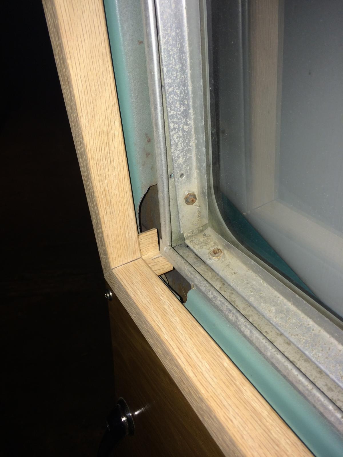

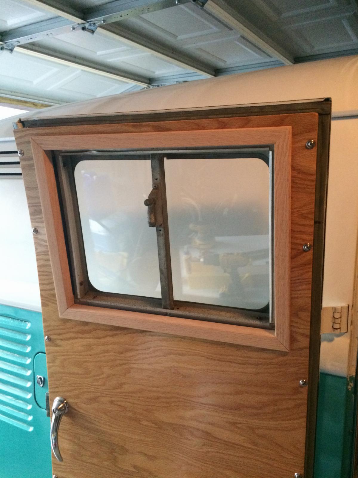

PostPosted: Sun Apr 10, 2016 7:17 pm    Post subject: Re: Hehr Westfalia Jalousie Restoration ?'s Reply with quote
Pics of my oak window trim. I used 3/4 corner trim found at Lowes hardware. It isn't varnished yet, as this is my prototype. The one picture I don't have is the back side. I used the corner trim cut to 1.5" to attach the 4 pieces. They also act a a guide to grab the corners of the metal window frame. The frame is glued together with tightbond wood glue and is very strong.

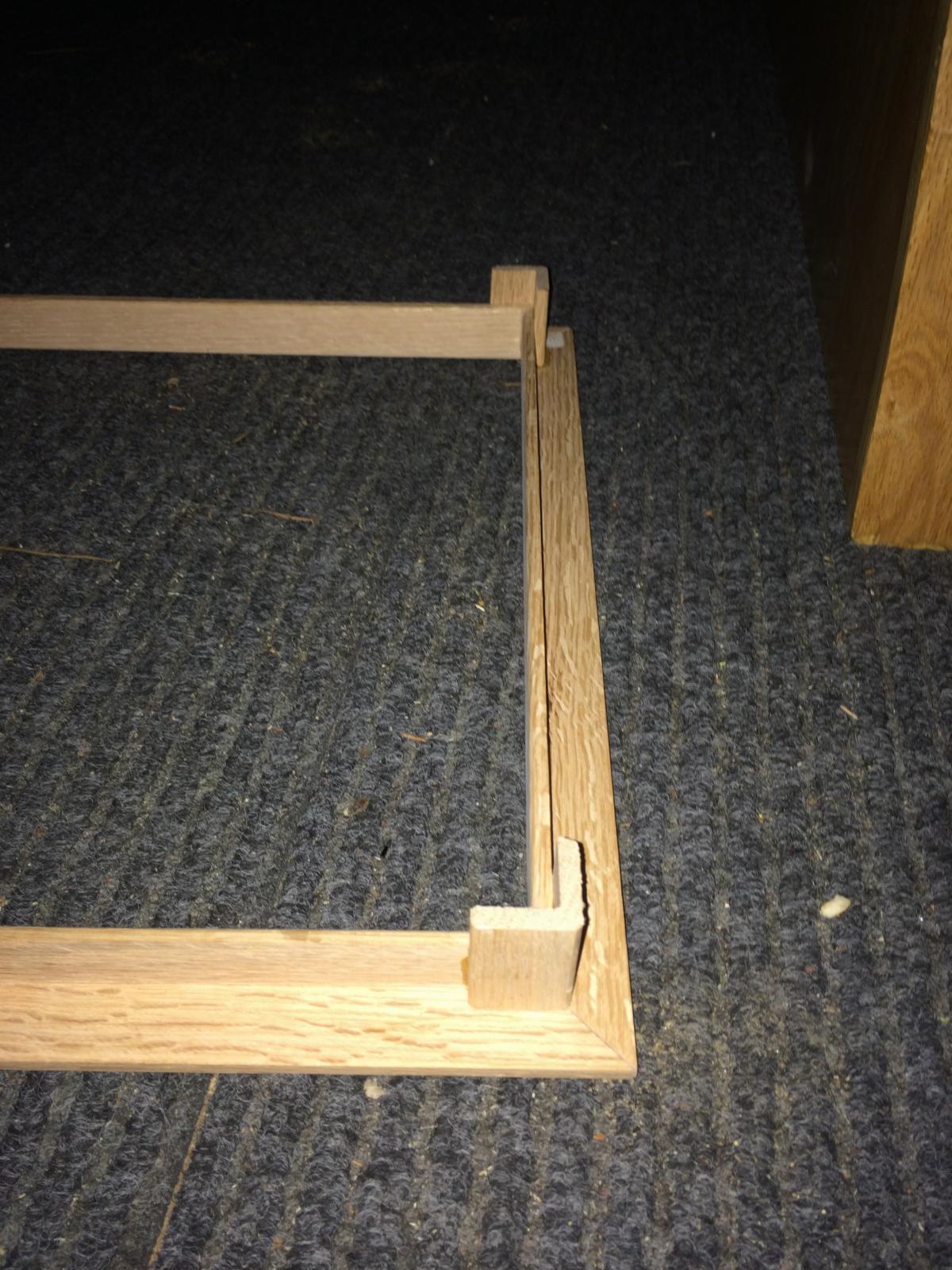

I ignored the curve and just built a frame from wood. There is a small gap midway behind the vertical pieces but it isn't noticeable.
The Hehr jalousie windows actually stick into the interior of the bus so the corner molding isn't needed. I used 1/2" thick poplar cut to 1" width but 3/4" wide would probably be closer to a stock appearance. As you can see, with this bus stock wasn't important.

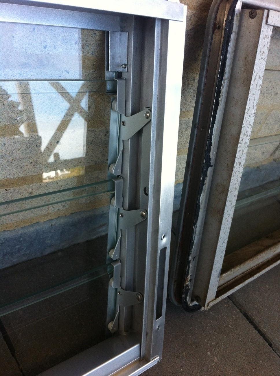

Has anyone got a How to guide in installing the glass into the hinges? I have two window panes which have come out of their seats in the hinges and i can,t get them to slide back into place. Westfalia so42 windows
srfndoc
Joined: August 21, 2010
Posts: 3275
Location: SoCal
srfndoc is offline
PostPosted: Sun May 01, 2016 1:18 pm    Post subject: Re: Hehr Westfalia Jalousie Restoration ?'s Reply with quote
The glass should be easy to slide in although you may have to bend the tabs open a bit that grab the glass where there is no rubber bumper. The glass fits loosely in the glass holders until the rubber bumpers are put in.

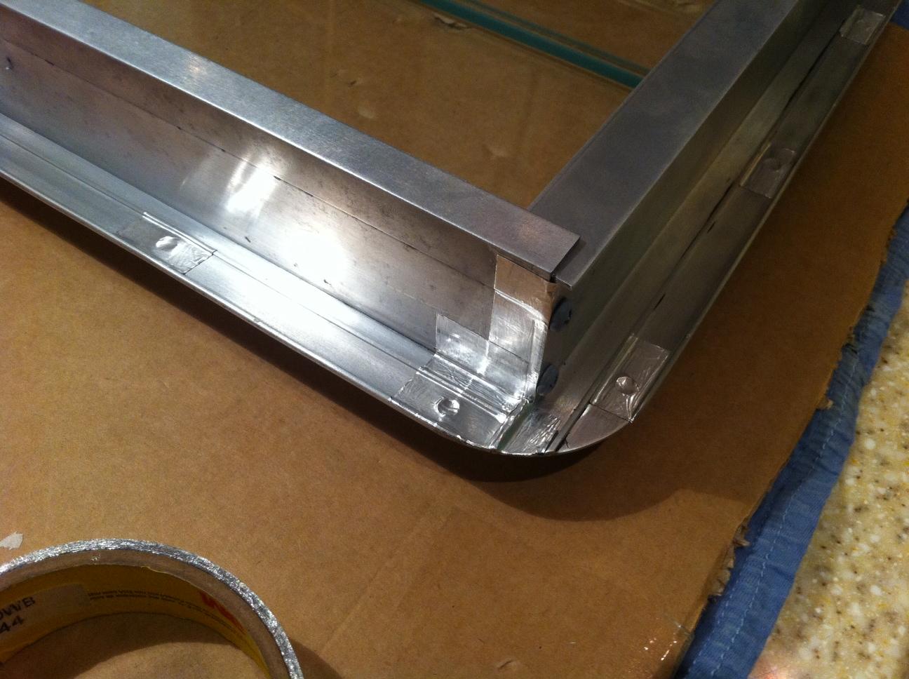

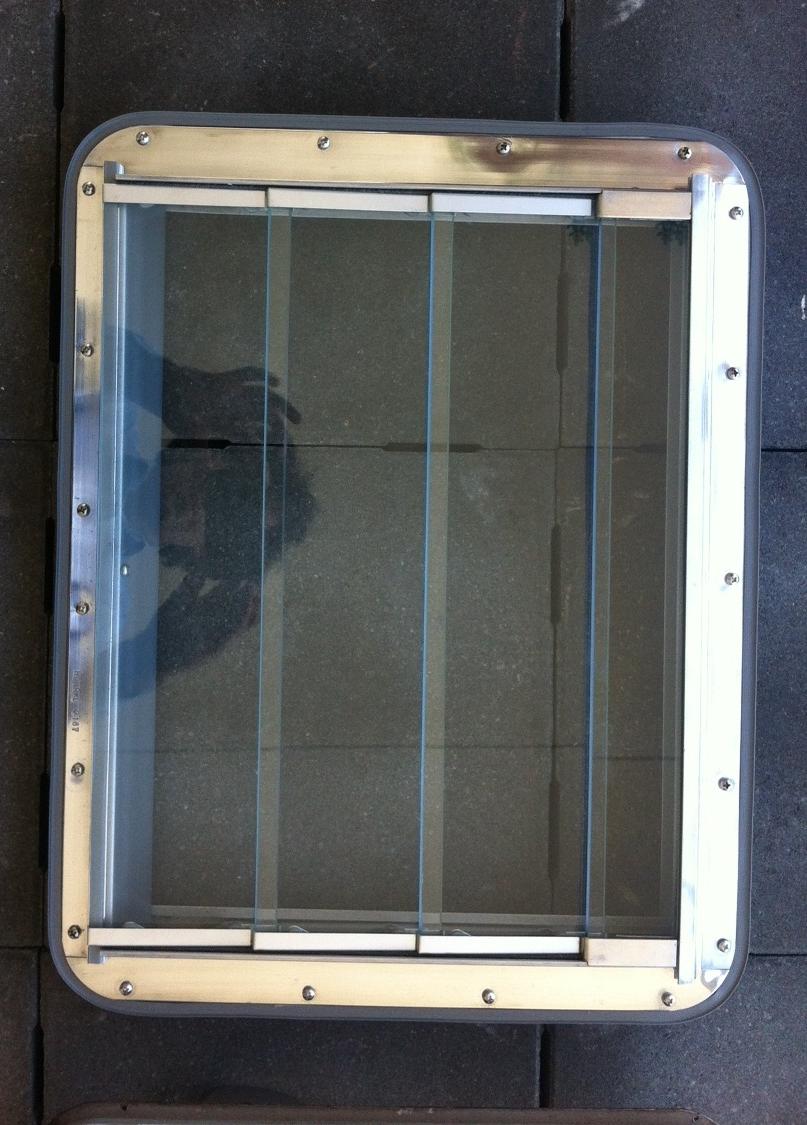

Sterkman, I really like your improvement with the aluminum tape, quick question how did you get the grey rubber trim to seat in all the way around and what did you use for polishing? I'm finishing up my last 2 windows and it is taking way too long. As for the grey rubber I had 2 windows which the rubber pushed out and I have to re-seat.
Sterkman wrote:
Now that I am at it, it might as well tell my full experience.
THE MOST COMPLETE METHOD:
I found particularly helpful page 6 of this thread by JOGR (rivets) and also very helpful DadaCheese his contribution on page 8 of this thread, and of course all Major Woodys comments.
I do not want to repeat what was already written before, just add some details that might be helpful.
I disassebled the complete window (that does not require much time and might speed you up later) and first cleaned with water and soap and scotchbrite all parts. I then used a fein oscilating machine with scotchbrite to clean all large accessable surfaces (no WD-40 needed, just creates a mess in my eyes). The hard to access parts on the inside of the frames mainly I did with a dremel. Finishing touch for all surfaces with some really fine steel wool and done. A mill finish everywhere.
I chose to polish the outside with a polishing disk attached to a hand drill machine. Takes only 10 min for one window. You do need rough and fine polish. This method gives very nice results and with the appropriate tools you can save hours of time.
I chose also to coat the inside of the windows. This because I don't want to redo this job anytime soon, and, some oxidation is so deep it created pitting (in my case) so you still would see little 'scars' of time. Giving it a coating solves this problem and will make it last longer. Here some pictures:
Bofore and after:
Inside before:
After:
WIP:
I tried to improve water tightness by putting aluminum tape on all splits and screw holes:
In the corners of the subframes I added silicone and between the subframe and windowframe weatherstripping (butyl putty tape) before screwing them together (vintage trailer supply product):
Some observations:
Vintage trailer supply has lots of good products. In particular, the pile seal that goes on the sides between the panes and the window frame has a plastic seal in the middle of the pile and therefore is better than the WW one.
I added a plastic washer between the jalousie glass holder and the window frame, especially since I painted the window frame on the inside. With the additional plastic in the seal I can still get a good seal:
Also I found their rattle pads better, they are thicker than the WW ones. The WW ones are not thick enough at least that is my experience and they fall out.
Here is the final result:
Still takes about a day of work per window. The last one a little less Very Happy

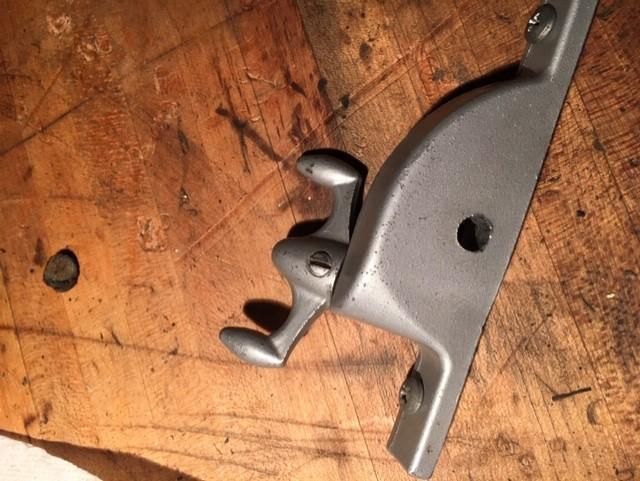

I have a 67 SO-42. I have a few windows out and plan to start some restoration. Not sure about all the polishing. I kind of like the classic look. My question is that I have two windows that aren't cranking. I have been able to loosen up the hinges and get them to move by hand. Then put the cranks back on and they didn't do anything. After further examination and comparing them to some working windows I notices that the "pin? rivet? round metal plug that pushes through the crank handle and connects the arm under the crank to the bar that moves the windows open and closed? (did you get that?) Whatever this part is it is missing.
My thousand words are not worth a picture:
Does anyone know what goes in that hole. Not really sure how it fell out. The other ones seem firmly pressed in.
Does anyone know of any sources?
Thanks
1967 Westy
easy e

PostPosted: Sat Feb 23, 2019 8:29 pm    Post subject: Re: Hehr Westfalia Jalousie Restoration ?'s Reply with quote
Revised to be concise:
gravee wrote:
I have two windows that aren't cranking (part is missing). Does anyone know what goes in that hole?
You should be able to see what you're missing:
aka: Evan
