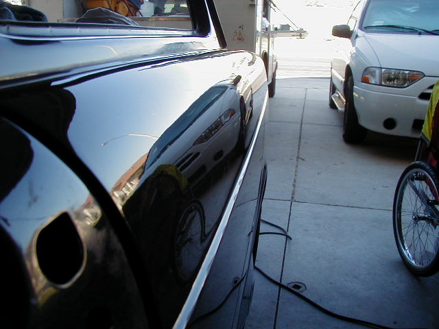

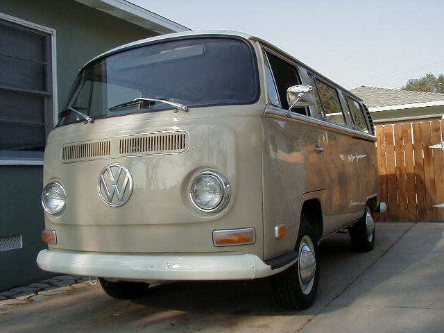

PostPosted: Sat Sep 17, 2016 6:32 pm    Post subject: Re: Just tried the HF HVLP sprayer.. UPDATED Reply with quote
here's a two stage ppg job done with the cheapo deapo HF purple HVLP...
so yeah I'd say they work just fine.. BTW the bus is single stage omni...

PostPosted: Sun Oct 16, 2016 10:50 am    Post subject: Re: Just tried the HF HVLP sprayer.. UPDATED Reply with quote
So ...what's that 'muffler-looking' thing in the rear passenger side wheelwell?? Muffler for a gas-heater??
Nice paintwork, BTW!

PostPosted: Sun Oct 16, 2016 3:59 pm    Post subject: Re: Just tried the HF HVLP sprayer.. UPDATED Reply with quote
Charcoal canister for evap system.

PostPosted: Sun Oct 16, 2016 4:29 pm    Post subject: Re: Just tried the HF HVLP sprayer.. UPDATED Reply with quote
ah hah ....72 Super. Got it. Funny, on the earliers, like my 66, that had the gas heater mounted above the transmission (under the luggage pane), they had a straight pipe coming out there that was the exhaust pipe for the gas heater ....never saw one with a muffler, though. LOL
...there's a line you can string someone!!

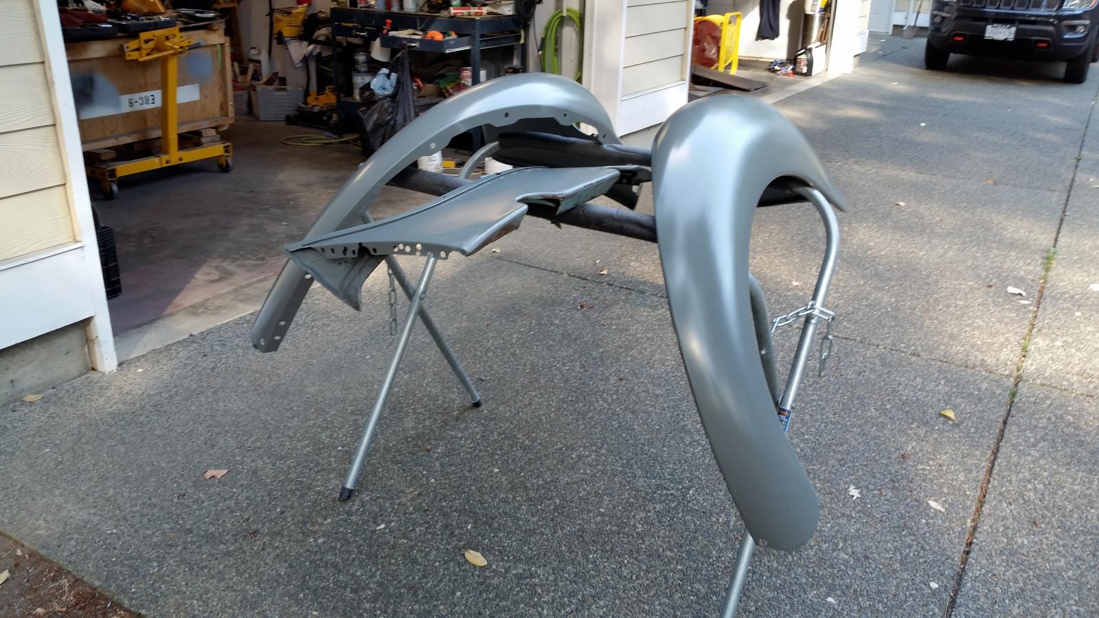

PostPosted: Tue Aug 21, 2018 8:44 pm    Post subject: Re: Just tried the HF HVLP sprayer.. UPDATED Reply with quote
Horse Hockey. Most of the posts on this thread are horse hockey. There is absolutely nothing wrong with using HF a cheapy gun. Is it as good as a Sata? Not even close. Will it do good job? Damn right it will.
A cheapy HF is certainly scraping the bottom of the barrel , a 150$ ProTec will work much better (which is what I use for base/clear) but a HF will do the job too.
It's like welders: in the right hands a 90$ HF flux core will do miracles, in the wrong hands a 2000 TIG machine will make a mess.
Buy a cheap gun and practice. Talk to the guys at the paint shop. The worst that can happen is you'll have sand out learning experience and do it again.
There are SO many other things to consider in a paint job the gun is pretty much the least of your worries. Having the courage to try is the key.
