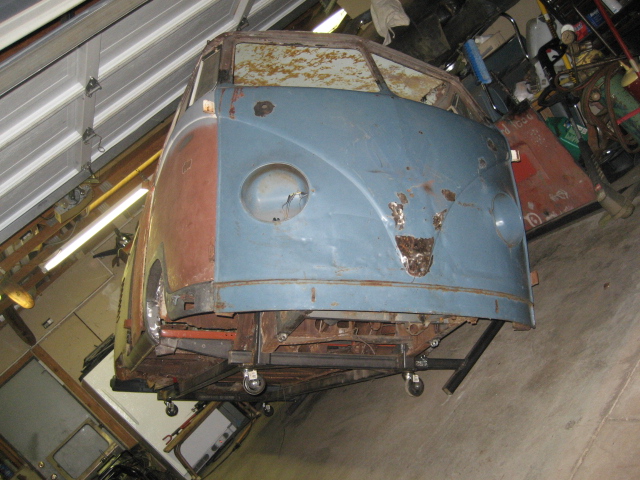

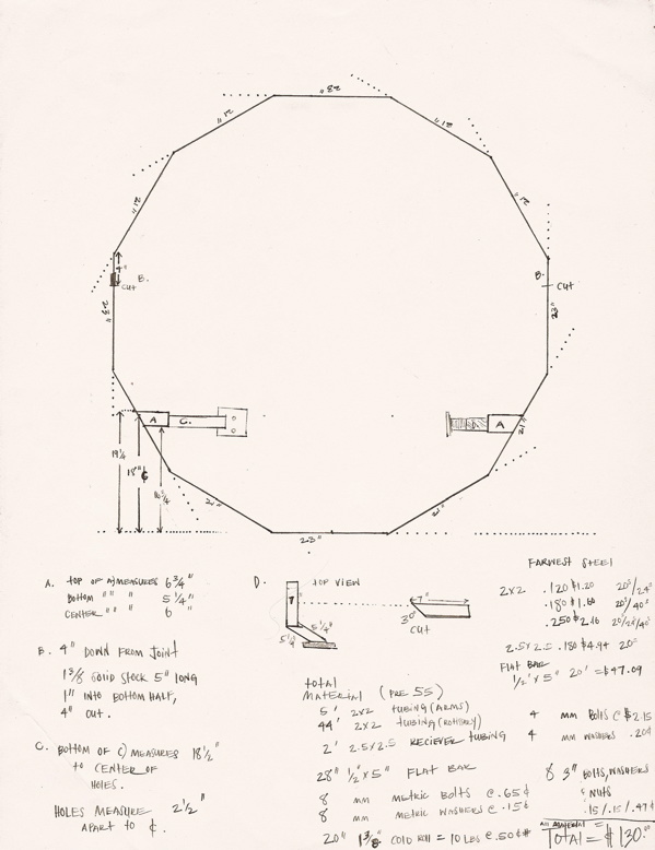

Build @ your own risk. I Michael Allen of the Studio 3 Project, assume zero responsibility to these plans, rotisserie and all person's using them. I have donated my ideas and time for free to aid in the restoration of projects. Please apply common sense when building this contraption, and Safety first!
I built this from $50. in scrap materials. I estimate new material cost @ $300. This design was ideal for transporting use. Other rotisseries may be more appropriate for in place rotation. My design is simple and builder friendly. Take your time and study the plans. You will need a welder, welding mask, 1/2 drill, 1/2 inch drill bit, chop saw or cutting devise, tape measure, thick leather gloves, safety goggles and possibly a calculator.

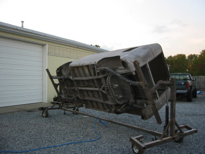

Step one: Build a 30 degree jig out of 2 x 2 angle iron; Weld the two 23 inch angle iron sections (long point to long point) with 15 degree cuts @ a perfect 30 degree angle. To verify true degree reference length of A sq. + B sq. = C squared.
Step two: Cut your 0.23622047 decimal inch wall thickness 2" x 2" tubing @ 15 degree cuts to length. Mark all lengths, 21 inches and 23 inches. (Please see foot note). Pair the correct to plans sections in two, double check and make minor adjustments if needed. Break the rotisserie into a top and bottom, each should share parallels angles and one side. Using Jig, weld pairs, then weld pairs together. Now you have a complete multigon making a 360 degree circle, I.E. 12 30 degree angles make 360 degree multigon. Repeat this step for second multigon.
Step three: Cut your multigon "B" to a top and bottom, note location to plans. Insert "b" solid stock in bottom half and weld in place @ all four locations. Slide top half of multigon back in place and drill out a hole for a holding pin. Remove top half.
Step four: Weld "A" in place. Note "a" (receives a 2 inch x 2 inch tubing)

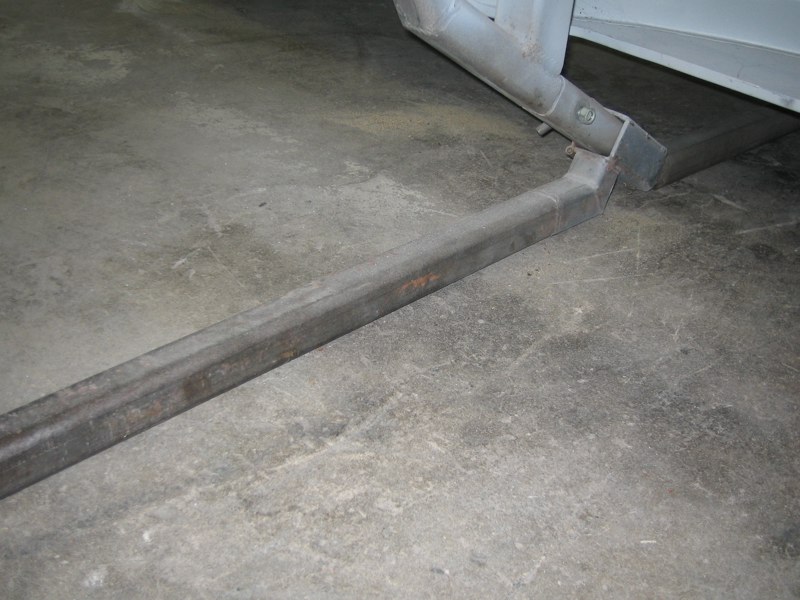

Step five: Make your mounting bracket arms and plates. Mount the plate's (flat 1/2" steel plate) in place  on your vehicle, and get ready for some muscle work. Slide the arms in place on the multigon. Raise the vehicle to center point of gravity. Raise the bottom half multigon with all in place, steady the bottom half w/ tack welded temporary stabilizer. Weld the arms "C & D" to the 1/2 plate that is bolted on your bus. Note: the bracket arms should be removable from the "A" pockets. Note: "c & d" were designed for barndoor bus, when building rotisserie for non barndoor; mount plates in place and correct the dimension width on arms prior to welding. Allow 1/2 inch of total play.
Step six: Build a safety bar. See jpg. This is very important. You don't want the bus rolling back on your ass or squashing your precious hands! Please note safety bar jpg. Use this bar.
Step seven: Lift the top half's of the multigon's in place and safety pin. Roll that bus over, safety bar the position and fix that nasty rust to factory standards. If its worth doing, do it right!
Foot note: 21 and 23 inch length's can all be changed to 23 inches. This will simplify the layout but make the overall height taller and you should consider the height of your garage opening prior to making this change.

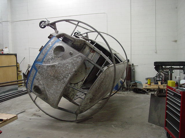

here some interesting ones;
this last 1 I like more!

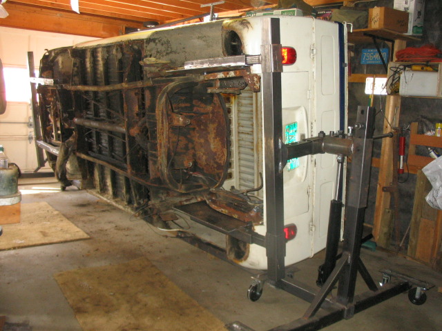

Hey, thats my truck ! Very Happy

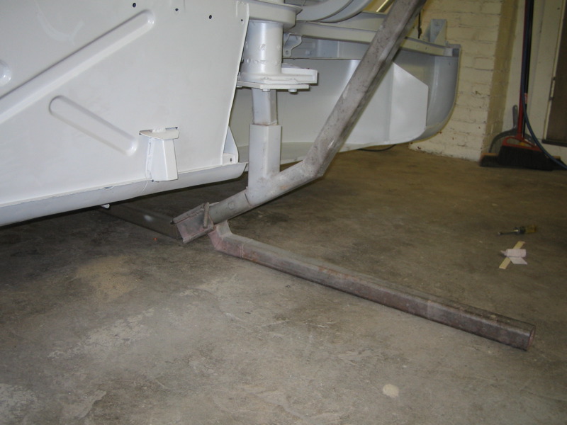

Here is a shot of the plates & arms I made to attach to the front end, you also can see the extra wheels added, to lower the rig down a few inches.
The best part is it works with a 8 foot ceiling, in basicly 1 garage bay.

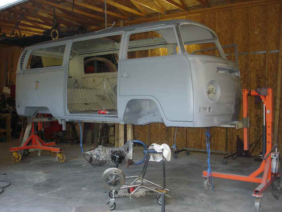

I like mine.
Why buy what you can build.
bubblehead
Joined: February 15, 2002
Posts: 525
bubblehead is offline
PostPosted: Thu Mar 27, 2008 5:28 pm    Post subject: Reply with quote
Jeremy
Could you post some more detailed pictures of your setup? I've been considering going the engine hoist route for a while. I see those things for sale cheap all the time and its similar to the ready made rotisseries out there.
Crukabs setup is really cool, just more coin than I want to spend. I also like the other one pictured above, with the two 45's that put it at a ninety.
In my opinion probably the cheapest, most effective setup.

LOL the swing axle is for a 67 deluxe belonging to my friend.
The rotisserie is scratch built from old wheelchair lift parts and box tubing. They look like engine stands but are much bigger.
